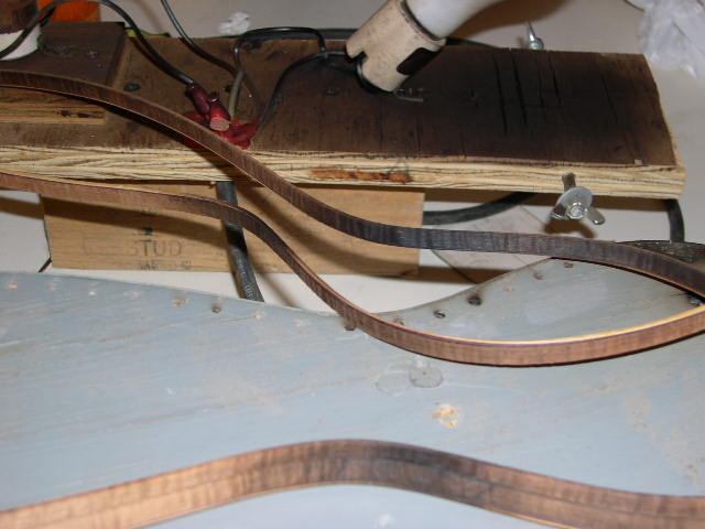

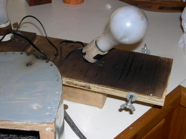

....and from the attached picture(s) can you tell what it was?
How about this one?

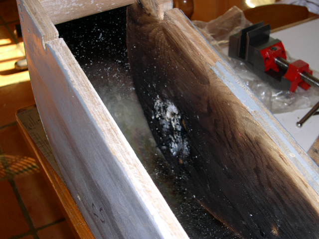

And the inside:

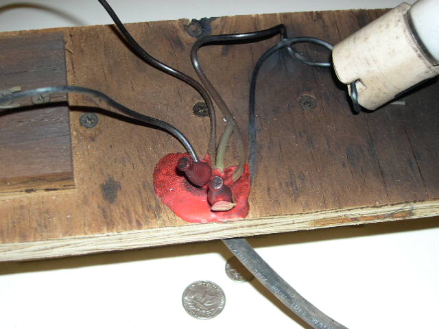

Did you notice what used to be the wire nuts? They are just a puddle of melted plastic now.
Yup, turn your back from your bender for just a minute, and you end up going to bed with the silly thing still on. I had gone up to the shop to set the bend in some pretty Koa bindings. Well, the bend is set now! I've never seen charcoal with such a memory:
It was just a fluke that took me back into the shop this a.m. I was on my way out of town, but thought I needed to go get something. Then I found all this. (And, unplugged it, for sure.) Well, I regret the loss of the bindings, the ruined bender, but I am so grateful that nothing worse happened.

Question 2: Steve, is this a closed box? Was there an air source for your bender?
I've seen electrical panel fires due to the fact that the cover was off. IF air can't get to the fire sometimes it smothers itself. A good reason to keep electrical panels in place and tight at all times.

Thanks for your kind regards, guys, and the genuine concern. What happened is something like this:
My shop has an upstairs / downstairs configuration. All the bending jigs are upstairs. I'm *always* very cognizant about bending, and not leaving the form unattended. So, a couple of nights ago, I went upstairs to just set the bend in those bindings, came downstairs, and got distracted by something. (And there's always plenty to distract me downstairs.) I guess the older I get, the more absent-minded I become; for-- whatever got my attention downstairs completely displaced what I had just done upstairs! I thought about the new subject for awhile, and then went to bed. After turning all the shop lights off!
Bruce, the box is indeed basically closed. You see the bottom with the bulbs, and the shaped part fits over it, with maybe a 1/8" gap between ends.
Larry, I don't believe in "flukes" either. That's why I put them in quotation marks. And thanks for the binding offer, but I've got more. (I am seriously low in Brazilian rosewood though.... )
Thanks again for the advice and info.
And behold what just two 200 watt bulbs can do!
It seems so safe....
P.S. Ok, Larry, it was in italics, not in quotation marks. But the sentiment still stands.Steve Kinnaird38920.6204282407
